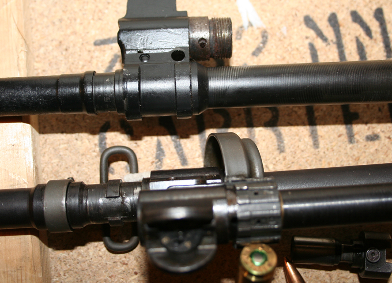

first off, the barrel isn't Steyr. pretty certain it's Inch pattern of some make.
i believe the only open-ear metric barrel was the Argentine and IIRC those used metric gas components (regulator, etc) which is not what you appear to have from the pic.
most all STG barrels have a half-length gas tube soldered into the gas block. also they were cut for the bipod which yours is not.
here's a look at non bipod and bipod cut barrels: (bipod cut is below)
Steyr STG barrels are marked like this (or a variation close to it):
this pic shows a short gas tube STG barrel below a full length
here are inch and metric gas blocks (inch on left)
a primary concern regarding the combination of an inch barrel and a metric lower is the sights. early FALs and all inch versions use a 3mm taller line of sight. replacing the rear sight with a (taller) inch or israeli version would rectify any elevation trouble you may be experiencing.

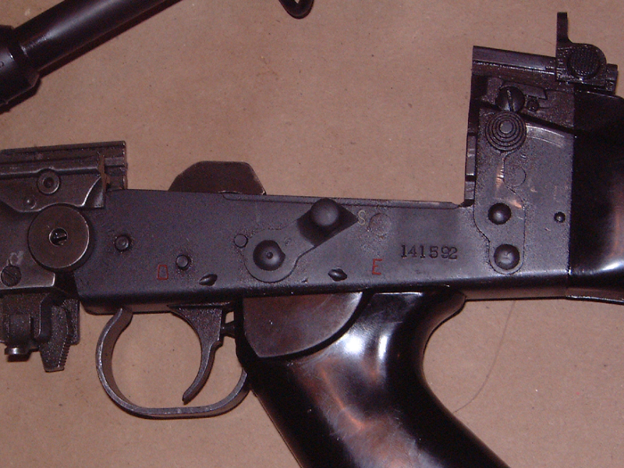

i do not think the lower is STG either, but rather G1. FN made all the G1s.
Steyr (Austria) made STGs under license after the first 20K or so were purchased from Belgium. (FN)
the reason i think it's G1 rather than STG is all the STG lowers i've seen have the serial # aligned at a level just higher than the "E" in the selector markings, and G1 lowers i've seen are marked as yours with the serial more along the same line as the "E"
compare this STG lower to yours:
