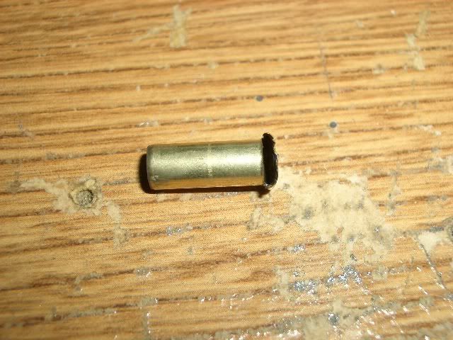

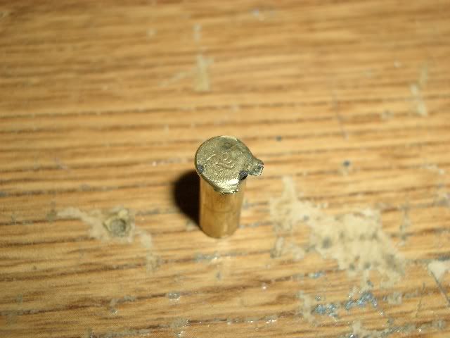

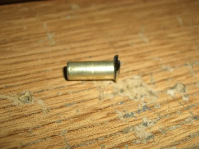

I just shot a remington bullet from my marlin and the thing exploded.
Besides killing my ears, it fucked my gun.
I cant open the bolt.
Im so pissed, this was my favorite gun in the whole wide world.
Where can i buy another bolt?
I still cant get the damn thing to open, so i guess ill have to assess the damage after i figure something out.
It looks like the only thing wrong is it messed up the arms that hold the bullet.
It will load one in the chamber, but wont eject it.
So where can i find that little thing?

While not eleminating a possible over charge,from the pictures I believe you had casing failure.The mouth of the casing never expanded which indicates rhere was no high pressure to expand it.The way I look at it the rim blew before the powder had time to build pressure.Make sure the bore is clear and the bullet isnt lodged in the barrel as not expanding the mouth of the case inducates very low pressure,maybe not enough to push the bullet out.As suggested,I would send the casing to Remington with the lot # which is on the opening flap of the cartridge box.I wouldnt fire any more cartridges.I would send all of them to Remington. sam.

It broke the extractor.There was no high pressure or it would have opened the mouth of the case.Make sure there was pressure enough to push the bullet out and get the new extractor and clip it on and go shooting. sam.
