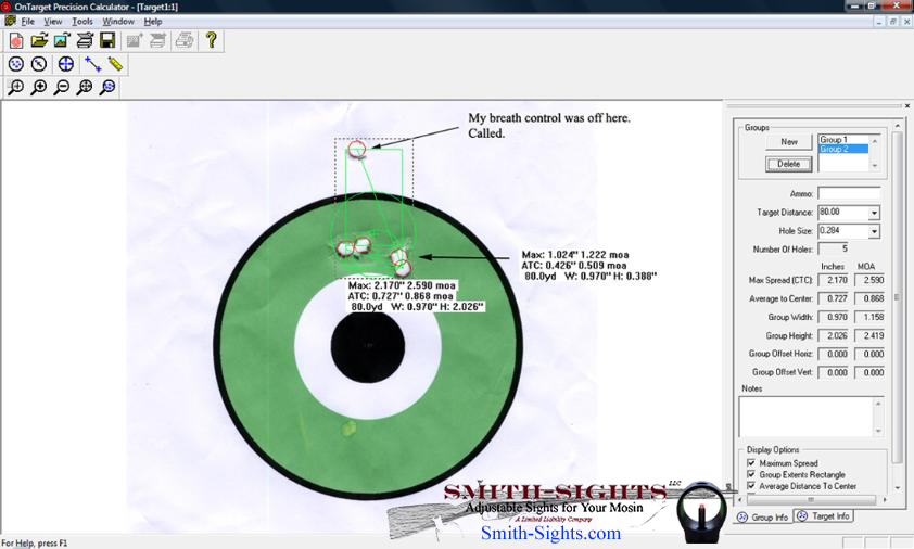

Hi Folks,
The target below was shot about one hour ago, at 6pm.
Now, at about 25 or 30 yards my range goes into the woods with a particularly thick canopy.
I had bright light shining on me and my rifle but was shooting into twilight. Target was about 80 yards out.
I was shooting prone, off a log. Just verifying zero after moving a pressure point on the barrel. No rear rest.
I measured both the best group, throwing out what I figure were fliers, and the whole group.
I was shooting for a bit of orange I could see. I figure it was the bottom of the target.
Is there a better way to shoot into twilight from a bright spot with open sights? I know I'm better than this as I usually do this maximum at 20 yards further.
Thanks,
Josh

You have 2 things working against you. If you are in the light your pupils will constrict making it hard to see in the low light. With the target in low light it's tougher to see the contrast of the bullseye.
There's no easy answer.

I would probably do something much simpler- like better contrasting colors.
A larger, white background, with a black dot (sized appropriately) for POA seems like it would be easier to spot/differentiate the bulls. Or, a large black background, with a white dot.
Just doesn't look to me like your choice of colors is highly visible, and contrasting.
