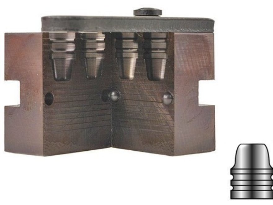

I ask because I'm looking at this bullet mold that throws these out:
Tin Cylinder Nickel Liquid Aluminium
Rectangle Mammal Font Magenta Circle
Because I'm wanting something as close to the 230gr Hornady XTP in profile and weight. Plus maybe current velocity as I can get.
Anyone use this or something similar in weight and profile?

it'll work just fine.
the TC type nose was the original design for the 9mm, hardly anyone uses it anymore, but it still feeds perfectly and is viable for self defense.
anyway look at it kind of squinty next to a hornady XTP bullet, you'll see.

See if any retailers are selling this type of bullet, if not perhaps a friend has a mold...try some and see how they work.. As stated above some 1911 can be finicky, I can usually get a 1911 to work...all can have idiosyncrasies..Take a look at Missouri Bullet Company ; I have had outstandingly good results with their bullets..
6,028 Posts
I have that mold, and used bullets from it in a couple of Taurus PT 1911 pistols, and a Tiger SR1911. Functions flawlessly in all 3. I think you will like it a lot.

I bought this one several years ago to use in my Ruger 45acp Revolver and it shoots out of my Kimber 1911s just fine.
I didn't pay anywhere near this price for it though.
