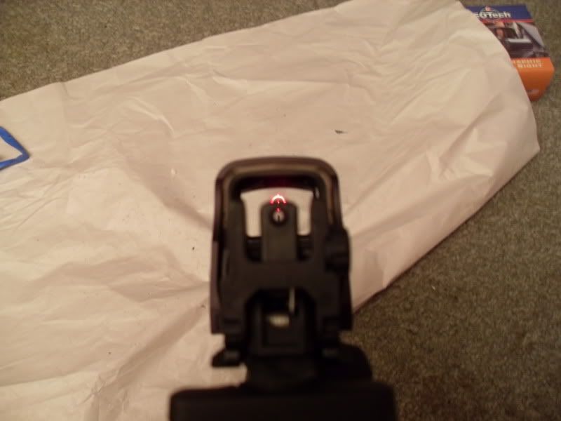

Here's what I have..
I have an Eotech 512, mounted with Magpul MBUS sights, front and rear.. The problem is that my gas block's rail on the front isn't the same height as the same as the rail on the upper..
I got the rifle sighted in tonight with the Eotech, but the front sight doesn't go high enough to get where it needs to be.. Even almost fully extended, I'm well short of the height needed to line up with the sights.
The rear doesn't have height adjustment, but only windage. All vertical adjustment is done with the front.
I haven't actually shot the rifle with the MBUS sights, but common sense tells me that the rear peep and front post should be pretty close to where the Eotech is showing it's point of aim.. Right??:confused:
My question is, should I see where the MBUS sights are shooting, or is there an adapter to raise the front sight the needed amount, in order to line up with the rear??
For some reason, in my head I figure that the Eotech's dot should match up with the MBUS's point of aim, or am I overthinking this??:feedback:

From your first picture it looks like you can still see the front sight post centered in where it should be with the rear sight.
Are you trying to get an absolute co witness or a lower 1/3rd co witness?
Absolute co witness means that the eotech dot will be perfectly lined up with the BUIS front and rear sight.
Lower 1/3rd Co witness seems to be more popular, the optic field of field of view will be mounted slightly higher than the BUIS sights so that the BUIS will be in the lower 1/3 of the optic making your FOV through the primary electronic optic less cluttered.
If thats not the case and your BUIS front sight really is too low for whatever your trying to do you could always unscrew the post and swap it out for a taller extended one. They do make them, they cost around $6.

In both the absolute co-witness and the lower 3rd co-witness you should be able to look through your BUIS and see the dot of your 1x optic sitting just on top of the front sight post. This is of course provided you have both the BUIS and optic sighted in for the same point of impact, which is what is normally done. When both the BUIS and optic are sighted in the 1x optic's reticle moves within the field of view as your eye moves in relation to the optic the dot will stay on target and at the point of aim and the shooter doesn't have to line his eye up behind the sight, this is true for optics that are parallax free such as EOTech and Aimpoint.
Sighting in the BUIS separate of the optic is okay but if the optic is already sighted in it would save time to adjust your BUIS to the same point of aim as your optic. You can then turn the optic off and varify making any corrections that you see fit but little if any sight adjustment should be nessisary if your optic is sighted in correctly. If your front sight is not at the correct height I doubt you will be able to sight it in at all because you will not be able to adjust your front sight post up hight enough. Your point of aim will be high. Your front and rear sight must be the same height from the plane of the barrel.
I hope I explained myself clearly. Bottom line, you will have to do something to get the front and rear sight the same height. A new front sight or a new gas block is needed provided you are correct and the front sight is too low, from your picture it looks that way to me.

I wanted to add, in looking at Paper's pictures again, it's visible that his gas block is already lower then the handguard. And if he indeed did get the Magpul front BUS that needs to be mounted to the handguard, it stands to reason it's even shorter then one that isn't designed to be.
It looks as if he were to mount just a rail to the top of that handguard, then mount that front BUS as far forward as he can, it should make it level with the rear.
But again, it is obvious the gas block is below the handguard thus making the front BUS too low.
This picture. See how the curve of the handguard curves over the gas block and rail on it?
I would also add that even if he got a different BUFS, he would probably run into the same problem. I think he got/went with one of those low profile gas blocks. If that's the case, that's the problem. Just needs top get a BUFS designed for a low profile gas block that will then raise it to the correct level as the rear...
